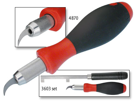

Anyone use this?
Stew Mac fret slot cleaner tool
PostPosted: Thu Dec 29, 2005 7:00 am
Hi Terry I used to, but I decided it was better to keep the glue etc. out rather than risk damage cleaning it out after.

I try to keep the glue used (titebond) in attaching binding to a minimum. Smooth it off with the finger to a nice light coating seems to work for me. I use the stew mac blades in a big Xacto handle i had around to clean out the sanding dust and any little glue bits prior to fretting though.
